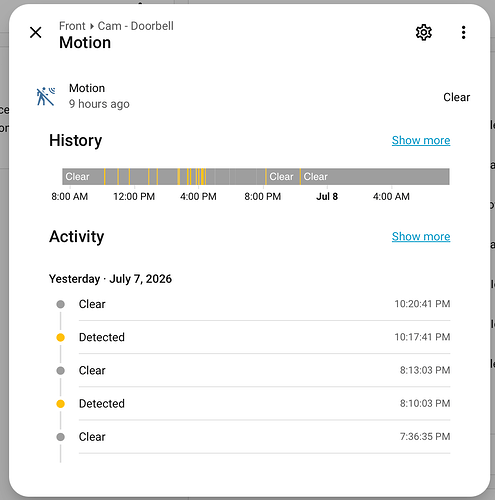

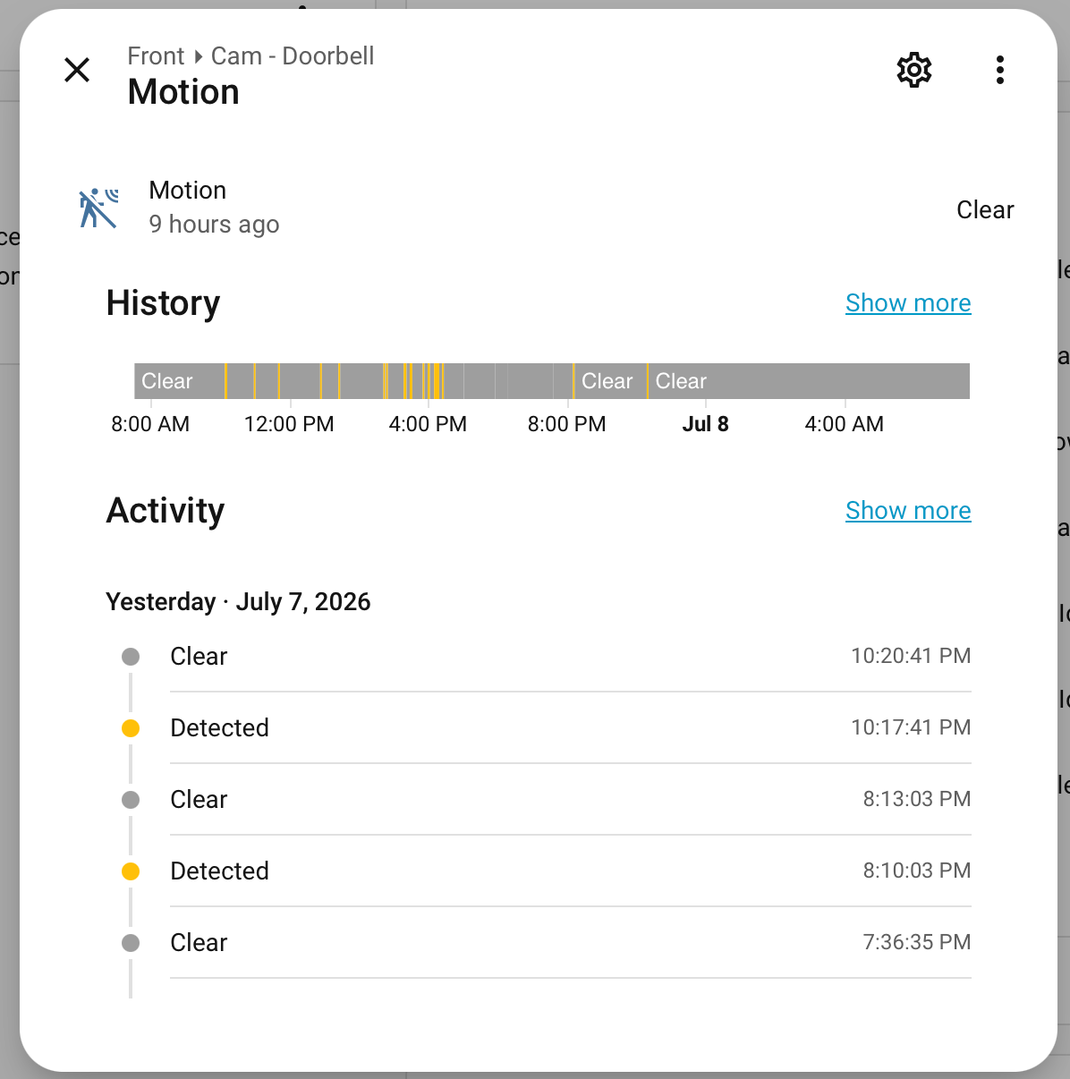

I have probably a dozen Ring floodlights/cameras, plus a ton of Ring sensors and lights, and they’ve been working just fine for me in Home Assistant for quite some time. The Ring integration exposes a binary sensor for motion detection (I have a Ring Doorbell Pro), and as you can see in the screen capture below, it detects and logs motion just fine (as least for me). I have an automation setup so when the doorbell detects motion at night it turns on several lights.
Assuming you have Home Assistant already installed, and you’ve already invested in “a lot of Ring equipment over the last year”, it’s pretty fast, easy, and inexpensive to just try it out to see if and how this would work in your environment.
