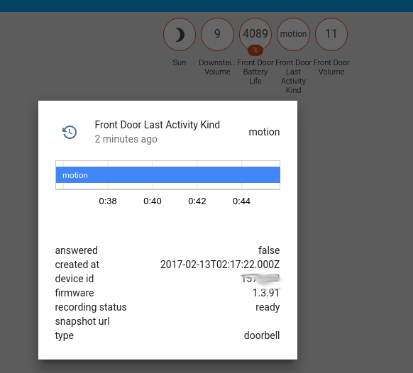

Guys, I’ve put some work on the Python library that we can use to create the Ring sensor for HA.
Could you visit https://github.com/tchellomello/python-ring-doorbell and test it out if will work for you?
You can see some description on the README on how to test it. I’m still making some changes and I believe by the weekend we will have the HA sensors prototype.

Guys, I’m putting the sensor together here but I would like see how the battery_life() function behaves on different environments to adjust the 3rd library.
Mine is returning 4107 and I’m trying to understand how it is displayed on other accounts.
