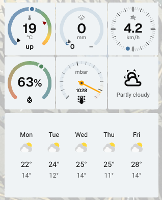

Thanks to you I have been able to rework my local weather panel to this. The temperature now show expected high and low, current temp as well as trend. I would lover to show trend as an arrow icon. This would mean the ability to use a template. This is currently not possible but could be a good addition to this card.

Can you share your yaml?
type: grid
cards:
  - type: custom:ring-tile
    entity: sensor.netatmo_thuis_binnen_buiten_temperature_trend
    ring_entity: sensor.netatmo_thuis_binnen_buiten_temperature
    marker: sensor.buienradar_minimum_temperature_1d
    marker2: sensor.buienradar_temperature_1d
    marker_color: slate
    marker2_color: darkred
    top_element: icon
    middle_element: ring_value_with_unit
    ring_size: 2
    ring_only: true
    min: sensor.buienradar_minimum_temperature_1d
    entity: sensor.netatmo_thuis_binnen_regenmeter_rain
    ring_entity: sensor.netatmo_thuis_binnen_regenmeter_rain_today
    marker: sensor.buienradar_minimum_rain_1d
    ring_size: 2
    ring_only: true
    top_element: icon
    middle_element: value_with_unit
    min: 0
    max: sensor.buienradar_maximum_rain_1d
    entity: sensor.netatmo_hg91_wind_strength
    marker: sensor.buienradar_wind_direction
    ring_type: compass
    indicator: pointer
    ring_only: true
    ring_size: 2
    top_element: icon
    entity: sensor.netatmo_thuis_binnen_humidity
    ring_size: 2
    ring_only: true
    top_element: icon
    ring_entity: sensor.netatmo_hg91_pressure
    scale: ticks
    icon: phu:air-presure
    ring_size: 2
    ring_only: true
    indicator: pointer
    top_element: icon
    bottom_element: value
    max: 1101
  - show_name: false
    show_icon: true
    type: button
    entity: weather.hoge_gouwe
    grid_options:
      columns: 4
      rows: 2
    show_state: true
There you go!

Trend arrows are an interesting idea. I’m curious to hear more about what would work for you. Would you use a custom sensor to detect the trend, or have ring-tile compute the trend based on the recent history of the entity? Do you have any examples of where you’ve done something like this in the past?
Also - I’m interested in the way the wind compass rendered for you. The wind direction marker seems to have rendered as a dot, rather than an arrow. I can’t immediately think of how that could be done - I’ve tried the YAML you pasted, but I get a different result. Is the dot preferred?
Thanks again for sharing - cool to see the different ways these get used.
For barometric pressure my weather station provides a sensor with a text value as it does for temperature. However I decided I preferred to show min and max temps instead of trend. If I could add trend as an icon as top_element that would be cool. As to the compass showing a point instead of an arrow I would prefer an arrow but can’t find the right setting. All in all your card is proving to be quite useful.

I get what you have in mind with providing a trend arrow option for top_element - sounds like a good idea. I’ll add it to my list of things to do (GitHub issue).
Compass should show a marker arrow by default, so if it’s not, you may have found a bug. The following YAML should work:
    ring_type: compass
    ring_only: true
    ring_size: 2
    top_element: icon
If this still isn’t working, let me know your device / operating system / browser version etc and I’ll see if I can reproduce. One thing to check is that your wind direction entity (sensor.buienradar_wind_direction) produces a compass angle in degrees.

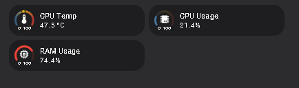

I just set this card up but am finding that some config options are being ignored.
All 3 cards have the same config other than the entity…
entity: sensor.dream_machine_pro_dream_machine_pro_cpu_temperature
min: 0
max: 110
colour:
  30%: ha_blue
  50%: ha_yellow
  70%: ha_red
entity: sensor.dream_machine_pro_cpu_utilization
min: 0
max: 100
bottom_element: min_max
colour:
  30%: ha_blue
  50%: ha_yellow
  70%: ha_red
entity: sensor.dream_machine_pro_memory_utilization
min: 0
max: 100
colour:
  30%: ha_blue
  50%: ha_yellow
  70%: ha_red

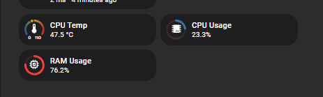

The first one has the min / max at the bottom but the other 2 dont…
Hey @sparkydave,
That’s because of the way I’ve done the default handling. Temperature sensors default to ring_type: open, whereas % sensors default to ring_type: closed. If you want to have min / max labelling, you need to use ring_type: open, so add that line to your YAML for the two % sensors.
Hope that helps.
Ah ok, thanks.
I just changed it per your suggestion and now they all look the same… except for one of the ring not following the same gradient. I guess that’s another default I need to look into?
That’s right. Temperature sensors default to indicator: dot, whereas % sensors default to indicator: arc. I find that “level” metrics (eg temperature) work best with a dot, while “consumption” metrics (like %) benefit from an arc to better represent usage. But of course do what works best for you!
Worth reading the docs. The config page describes all the options, including default handling. You’ll also find more in depth descriptions of ring_type, indicator and so on.
