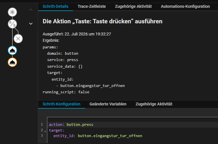

What does the debug trace show? Which step is failing?
your right. *twice!
but there is no error in the trace
There’s no Wait for Trigger action in the automation you shared…so either you shared the wrong automation or the wrong trace…
Also, please format your configs properly as you were asked to do previously.
I you run the action button.press in the Action tool does it work as expected?
yes. it works like a charm (needed 10 characters)

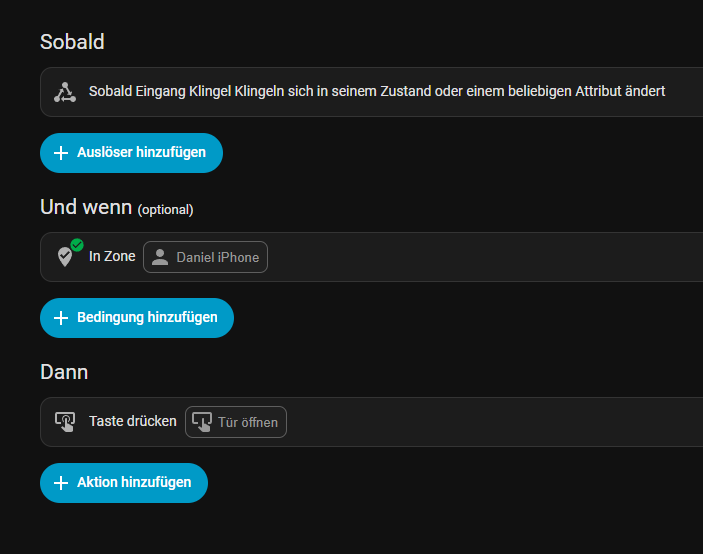

i try´d to simplify it, but still doesnt work.
description: ""
triggers:
  - trigger: event.received
      entity_id: event.eingangstur_klingeln
    options:
      event_type:
        - ring
conditions:
  - condition: zone.in_zone
      entity_id: device_tracker.daniel_iphone
    options:
      behavior: any
      for: "00:00:00"
      zone: zone.home
actions:
  - action: button.press
    metadata: {}
      entity_id: button.eingangstur_tur_offnen
    data: {}
mode: single
or
description: ""
triggers:
  - trigger: state
conditions:
    options:
      behavior: any
      for: "00:00:00"
      zone: zone.home
actions:
    metadata: {}
    data: {}
mode: single
im in the zone :smiley: but automation wont fire the button

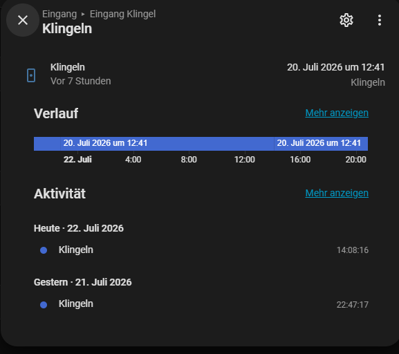

i guess i found the problem, but no solution.
for some reason the “ringing the bell” isnt recognized.
the door bell rang a “few” times today…
The YAML you shared has the event trigger on
- ring
Could it be a localization issue where it might need to be in German, or perhaps Ring?
If not, you could try and use a state trigger on the doorbell event and trigger on Any (blank). I did that before the new event trigger was added, but I’m not sure how resilient it is.
i switched to english. tryd, switched to german back again, tryd "event type: “klingeln”, back to english again and tryd the aditions trigger.
no solution

Under the dev tools there’s a section (tab) for events. Can you capture the raw event data there for when a button is pressed?
SOLVED
after a few hours of testing, running outside, ringing, get inside again aso …
i got the thingy running but with full-auto on the door opener. it wont stop until i stoped script.
the problem is/was that my ringing isnt recognized some how…
