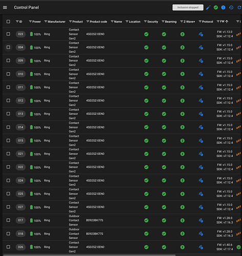

FWIW I kept a couple of devices paired to the Ring hub for several days and never got firmware update prompts :frowning:. Maybe just bad luck; I really wanted the new firmware on my Keypad gen2 so it would support motion sensing!
I’m also wondering why I have so many different versions of contact sensors, and how I could potentially update those!
