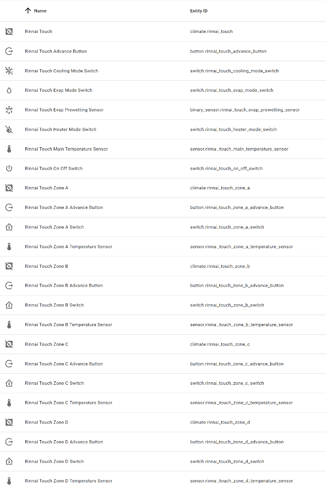

I’ve pushed a fairly large update to the develop branch (https://github.com/funtastix/rinnaitouch/tree/develop), much of which I cannot test in my system. It contains a lot of entities for zones:
- ClimateEntities for each zone (all zones are added, but only the installed ones are enabled)
- Temperature sensors for the system and for each zone
- Switches for each zone
- Switches for each mode
- Advance button for the system and the zones
- On/Off switches for the zones
- A binary sensor for prewetting for evap mode

I have done as much testing as I can, but I expect bugs. Still released it as 0.4.0 so it’s more widely accessible without git.
A number of additions for that release:
- added sensors for temperature, target temperature, pre-wetting
- added all zones as separate climate entries
- added a select entity to switch presets (heat, cooling, evap)
- added switches for system on/off, manual/auto, preset modes, water pump
- added advance button
- added a small event system to make updates get to the UI faster and more consistently
keep up the good work. I am a little distracted with the impact from recent hailstorms… dealing with the damage. Will get back to this when things settle down.
No worries. Hope things are not too bad. Here’s a summary of what the integration can do so far:
PS: I don’t have cooling nor zones, so I’m mocking zone A and B with the main climate entity, but there’s an entity for each zone.

When adding the integration, it assumes the device is called Zone D.
With regards to entities, It seems to recognise zone c and d, however all I have is zone a and b.
