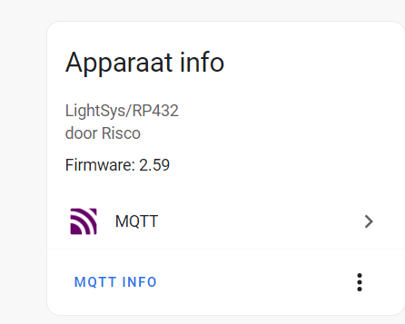

I have 2.x firmware on my lightsys, then it will not work, unless you replace the mainboard too…
how can i know?
I checked my firmware version in HA (using the addon, the mqtt integration tells you). I was on 5.something and updated on the risco panel to 6. Not sure if you can see the version on the panel.
You can also see it somewhere on the panel indeed, or the integration
If you have 2.70 or lower, you are out of luck, like me ![]()
Try updating the fw via the panel (in the installer menu)
Seems on same release as mine, 2.70 is the max for that older panel…

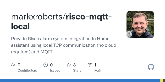

Use this version, it’s more up to date and stabler for proxy disconnects…
