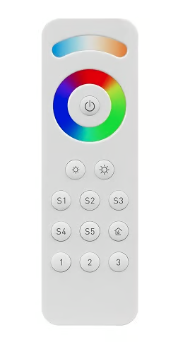

ROBB smarrt 3-channel RGB, CCT, dimmer and scene remote controller on ZHA
Blueprint to create automations for ROBB smarrt remote controller known also as Remote Ultra.
Get this blueprint to your HA.
Features:
3 channel
Assign multiple lights to each channel and toggle channels with 1-3 buttons. So it’s possible to control even all selected channels at the same time.
Power button
Toggles lights on or off.
CCT slide
Controls color temperature from cold to warm.
RGB wheel
Controls light hue 0-360°.
Dimmer buttons
Dim or brighten lights in 10% steps with short press.
Continuously dim or brighten lights with long press.
Scene buttons
Store current light settings as a scene with long press.
Recal stored scene with short press.
1-5 scenes for each group. Button 6 is not working as it doesn’t send any event to zha.
