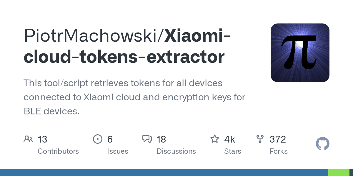

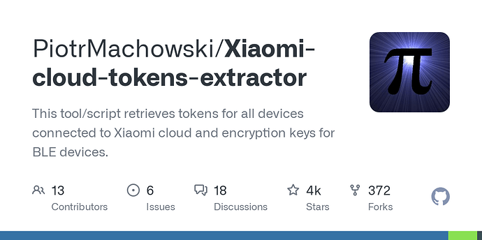

You got two choices when adding the integration, either add devices using the Mi Home account or use manual mode entering the username/password for the Mi account, local/lan ip-address to the E5 and the token for it. You have to extract the token,i used this executable to do that:
