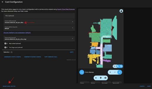

So, on HACS search and install this:
Lovelace Vacuum Map card
Once you have it installed go to any of your Dashboard and add a New Card.
Search for Custom: Vacuum Map Card
github reference: GitHub - PiotrMachowski/lovelace-xiaomi-vacuum-map-card: This card provides a user-friendly way to fully control map-based vacuums in Home Assistant. Supported brands include Xiaomi (Roborock/Viomi/Dreame/Roidmi/Valetudo/Valetudo RE), Neato, Wyze, Roomba, Ecovacs (and probably more).
On the field “Vaccum entity” add your roborock ententy name (like per picture)
Now click on “SHOW CODE EDITOR”
You should see the default config, like this:
Go back by clicking on “SHOW VISUAL EDITOR”
now click on “GENERATE ROOMS CONFIG”
once again click on Show Code Editor and you should see something like this:
Where ID 16 is a room and you just need to send your roboot there to find where it is
You can also edit it where it says “text: Room 16” and change to the room’s name.
For last, don’t forget to SAVE :wink:
I hope it helps.

hey @wgumaa,
You can use the previous instructions and you should be able to send the vaccum to where you want.
Or - You can:
Click on the button: Zone cleanup (as per picture)
Then select: Rooms
Now you can see all rooms’ name on top.
Let’s pick “Room 29” or “Room 26” as example and change their name
Go back to to Edit mode in the Vacuum Map Card
Click on the "SHOW CODE EDITOR’
Find your “Room number” - in this example I’m choosing “Room 29” - and name it as you wish.
Example:
From Room 29:
To new name: Livingroom
Once again, don’t forget to SAVE your changes.
As result, now you can tell which room number is related to their location:
I hope it helps.
Cheers :wink:
