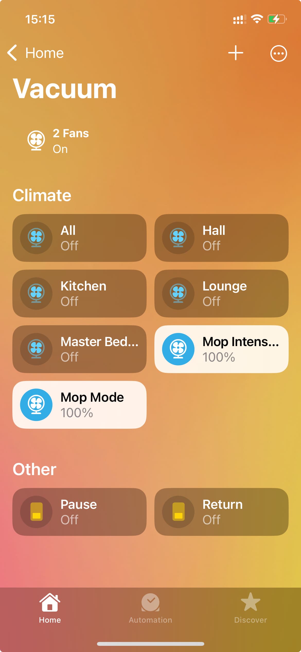

  • A HomeKit bridge for Roborock
  • A ‘fan’ switch for each room configured.
    • This can be used as a simple on/off switch to start cleaning the pre-configured ‘room’. (on = clean, off = pause).
    • The fan setting allows you to set/change the suction used for each ‘room’.
  • An on/off switch that can be used to pause the vacuum (on = pause, off = resume)
  • An on/off switch to return the vacuum to the dock (on = return, off = pause)
  • A ‘fan’ switch that sets the mop mode
  • A ‘fan’ switch that sets the mop intensity
When configured, it should look like this:
