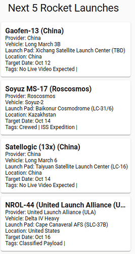

I might be a little space obsessed, but after putting out my SpaceX sensors integration, I figured I would like to also be aware of other non-SpaceX launches that I might get a chance to watch.
I released the first version of my Rocket Launch Live - Next 5 Launches integration last night at https://github.com/djtimca/harocketlaunchlive (compatible with HACS custom repository install).
This integration uses the free rocketlaunch.live API for the next 5 launches and currently adds 5 sensors (one for each launch) with a ton of information in the attributes for each launch. I expect to add launch warnings etc like in my SpaceX Integration but need to monitor the data for a bit to understand how/when it will come in.
Happy to get testing feedback and suggestions as well.
I am currently showing the launch info using the custom:button-card (from HACS) in my Lovelace with the following YAML:

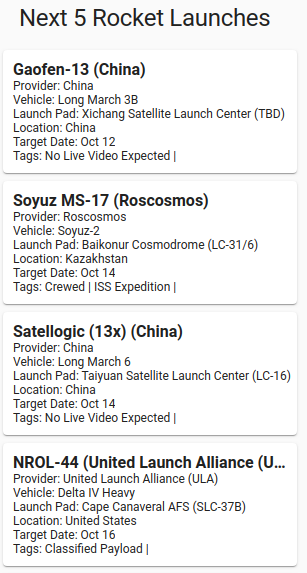

Released version 002 which allows you to enter a paid API key during setup (you can register/subscribe at https://rocketlaunch.live for minimum $3USD per month).
Adds new attributes to each launch:
  • launch_media_link - YouTube watch link for the launch (premium only)
  • launch_target - Target launch date/time in your Home Assistant local time
  • launch_target_timestamp - Target launch date/time in UNIX timestamp
  • launch_24h_warning - true/false if the launch is within the next 24 hours
  • launch_20m_warning - true/false if the launch is within the next 20 minutes
I updated my cards to show the updated launch target date (in Home Assistant local time) and to flip the cards yellow and red if the launch is within 24 hours or 20 minutes (new warnings added). If you have a premium account you could also include the media link to the card. Updated cards (without the media link) are below:

    layout: icon_state
    styles:
      card:
        - font-size: 12px
        - padding: 10px
        - background-color: |
              if (states['sensor.rocket_launch_2'].attributes['launch_24h_warning'] == "true")
                return "yellow";
              else if (states['sensor.rocket_launch_2'].attributes['launch_20m_warning'] == "true")
                return "red";
      grid:
        - grid-template-areas: >-
            "s" "provider" "vehicle" "launch_pad" "location" "target_date"
            "tags"
        - grid-template-columns: 1fr
        - grid-template-rows: 1fr min-content min-content min-content
      state:
        - font-weight: bold
        - font-size: 16px
        - align-self: start
        - justify-self: start
      custom_fields:
        provider:
          - align-self: start
        vehicle:
          - align-self: start
        launch_pad:
          - align-self: start
        location:
          - align-self: start
        target_date:
          - align-self: start
        tags:
          - align-self: start
    custom_fields:
      provider: |
          return `Provider: ${states['sensor.rocket_launch_2'].attributes["provider"]}`
      vehicle: |
          return `Vehicle: ${states['sensor.rocket_launch_2'].attributes['vehicle']}`
      launch_pad: |
          return `Launch Pad: ${states['sensor.rocket_launch_2'].attributes['launch_pad']}`
      location: |
          return `Location: ${states['sensor.rocket_launch_2'].attributes['launch_location']}`
      target_date: |
          return `Target Date: ${states['sensor.rocket_launch_2'].attributes['launch_target']}`
      tags: |
          return `Tags: ${states['sensor.rocket_launch_2'].attributes['tags']}`

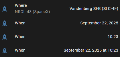

Is it possible to add the scheduled launch time next to the launch date?
I just created this Entity Card - still trying to find the best format for me, though:
type: entities
entities:
  - type: attribute
    entity: sensor.rocket_launch_1
    attribute: launch_pad
    secondary_info: state
  - type: attribute
    attribute: launch_target
    format: date
  - type: attribute
    format: time
  - type: attribute
    format: datetime
