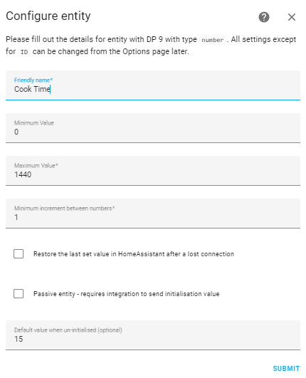

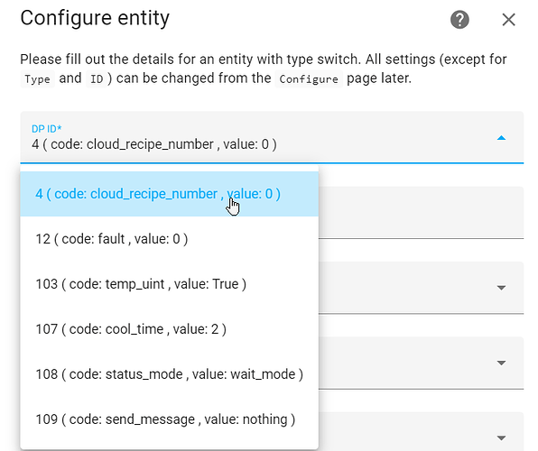

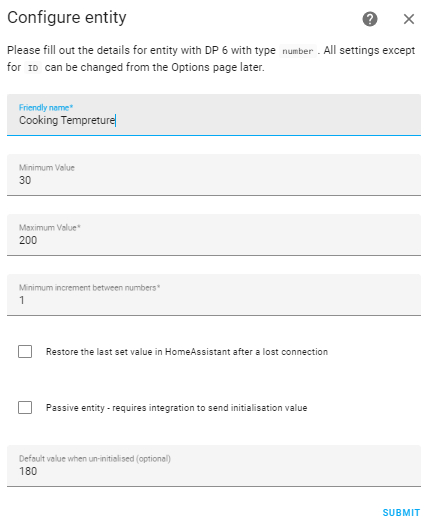

Please note you will need to add your Airfryer Via Tuya Android App, then get the ip and local key to do this localtuya, I will provide the screen shots of how it should be added as a device with screen shots, listing the entities, and the final yaml for the controls, you will need to download other cards e.g. chips, css mod, mushroom, etc to use this.
Add device with localtuya using IP and local Key.
You should end up with something that looks like this.
