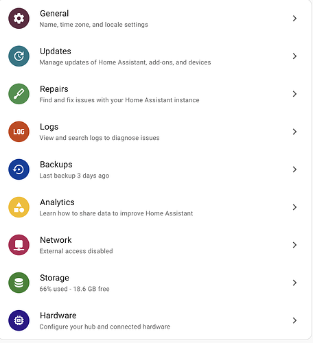

Where is that found? If I go to Settings->System there is no Advanced System Settings
In the Roku thing somewhere, they changed a setting to change access of things like HA. This one is all ROKU.
At least I believe that’s what happened.
