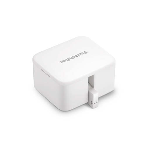

The alternate to that if the switchbot bot does not fit the role is a Fingerbot based on the type of button that needs to be pressed via one:
With both if you want to eliminate the need to use batteries then include a battery elimator cable that is made with the type of battery they use, which in both cases they use CR2 3V batteries.
edit: looks like they have a touch version as well… I may have to look into that and grab it to see how well it works when I have a device that can use it.
That was actually the one I was thinking of.
