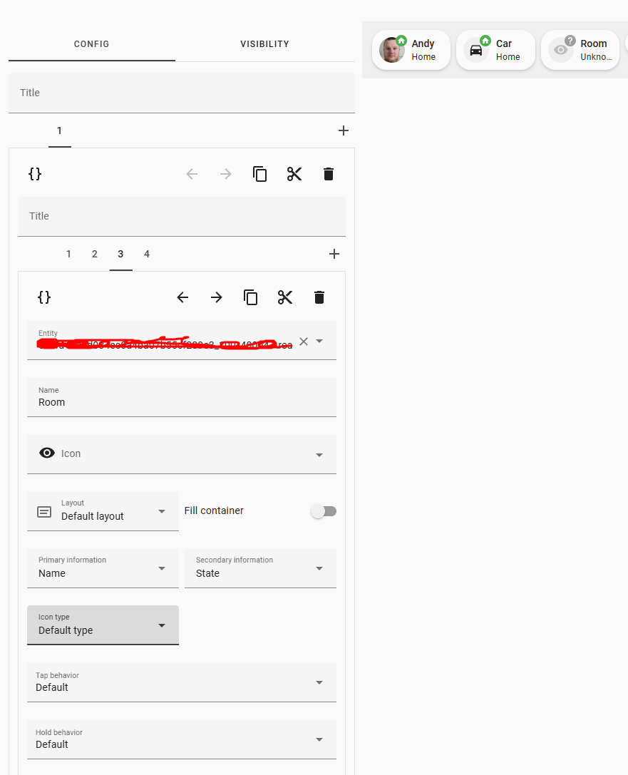

Ive set up esp and bermuda to get my phones presence in a room. When i look at the entity of my phone i can see its been detected in the room.
However im trying to create a chip which says which room im in and its just coming back as unknown.
You can see im tracking my phone and my car which works but then the unknow is me trying to display which room i am in.
How can i link the sensor.xxxxx to me as a person please?
Thanks
Andy
