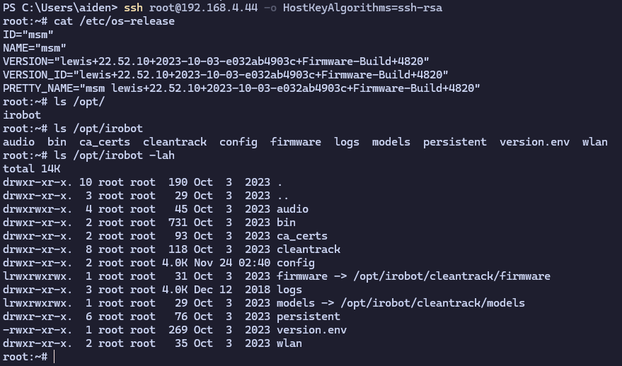

Hey all, not sure I can share the method yet, but for the first time publicly (i believe), me and another person (will add credit if they want) found a stable method to fully jailbreak Roomba, allowing access finally to the internal SSH server, and MQTT broker (and removing the need for cloud access with some tinkering i believe).

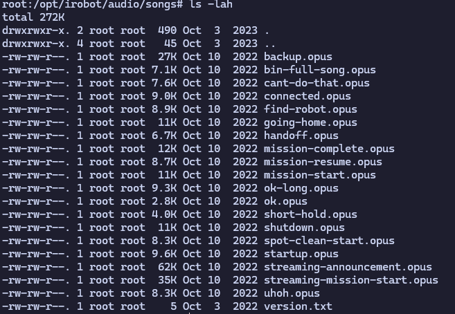

Here are some interesting images from my i7:

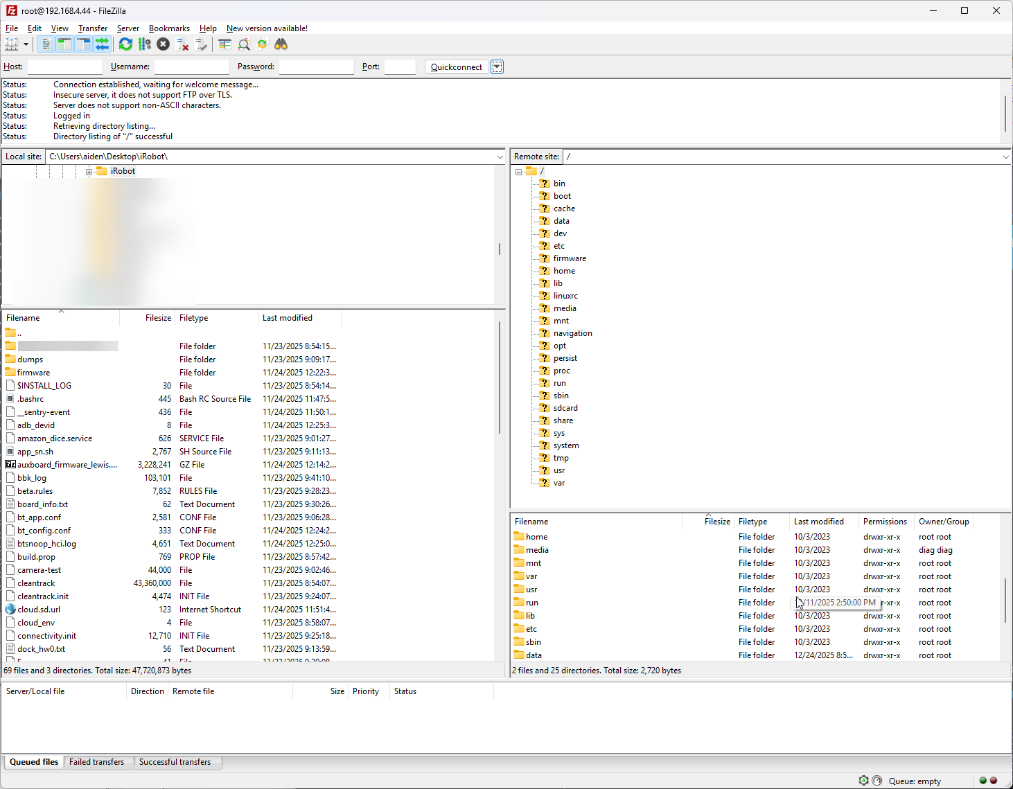

I’ve even managed to get FTP working, its a very limited Ubuntu+BusyBox distro. Digging through the file structure, we can find the very pmaps we previously extracted from the cloud. I also just dumped some files to my main computer to look at and see the contents. Very interesting stuff!
