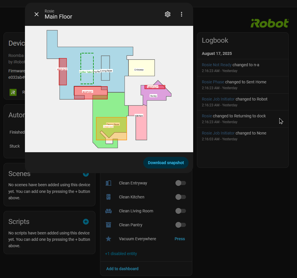

This is my latest project and first ever integration for HA, and it builds on jeremywillans’s YAML configuration while expanding upon it, allowing for selective room cleaning, favorites, and showing a map model (with even more stuff coming soon, as it’s still a work in progress!)
It uses rest980, so it’s easy to deploy that + the integration and start using.
Screenshots

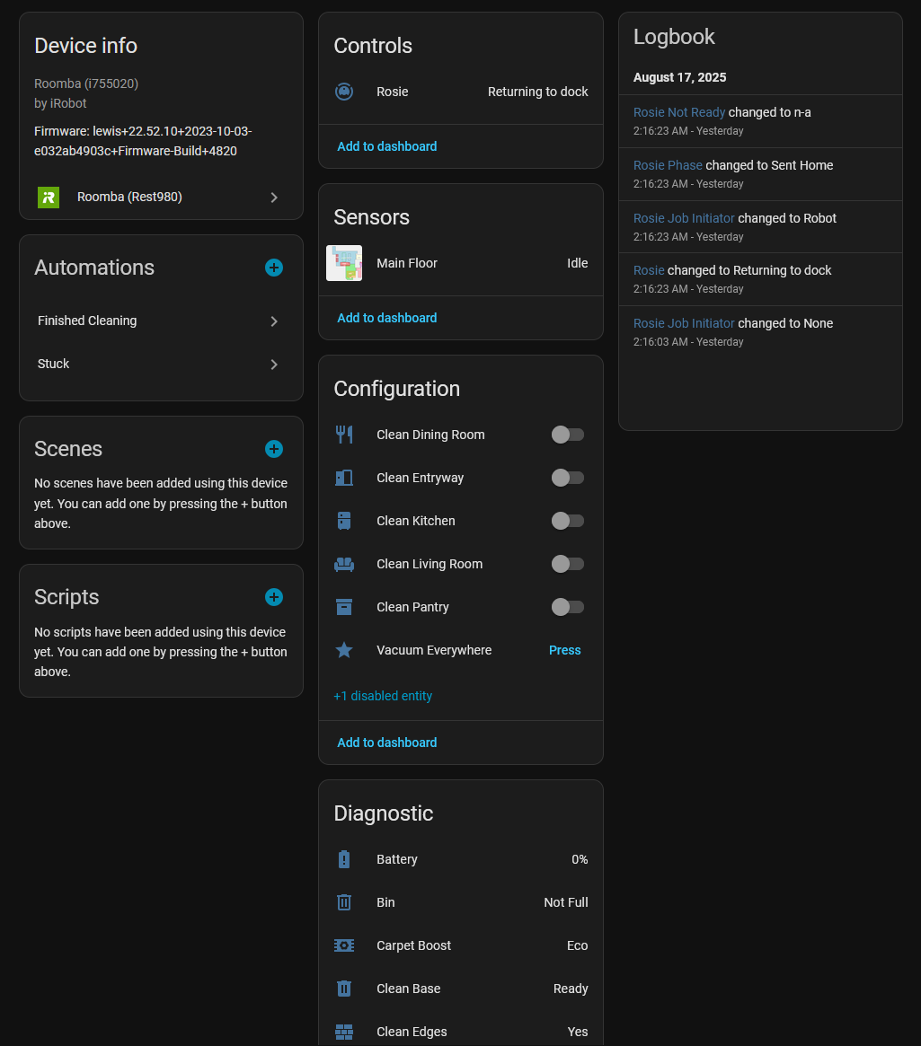

My robot is actually dead as of posting (why battery is 0%, my dock has issues making contact) but here’s the integration working! I’ll replace the images when I fully charge it. Besides that, the state is what was last before it died.
Maps / Rooms
Maps are not given locally anymore (firmware 2+), which is why this integration allows you to login with your iRobot Home credentials to actually give you the convenient options of switch-based room selection. You can however still send a manual JSON command if you want to stay local/know how to for any reason.
You are also not locked to being cloud + local, you can stay fully local if you just want the attributes! I even left the raw attributes exposed in case I missed a sensor.

Do you mean to use the selective room cleaning feature? For that, you toggle the switches given to you in the order you want the rooms cleaned then use the start button on the HA Vacuum entity.
If you do not see them, you have to add the robot with the cloud enabled switch. There is currently no way to simply do that with local room configuration [as of current!]. However, if you want do it purely locally you must send the action “rest980_clean” with this payload format (two data fields, one named payload for the actual data being sent to the vacuum, base_url is where the rest980 server is.)
