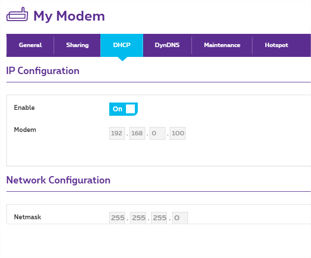

I’ve PiHole (best decision ever made) but I can’t configure it as DHCP Server because the ISP Box is refusing to delegate this role to something else. The option doesn’t exist on the technicolor and is grayed out on the sagem.

This is mine
