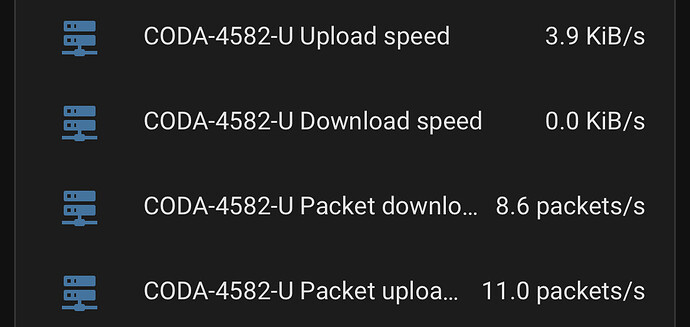

I’m also seeing the download speed sensor from the UPnP integration stuck at 0.0 KiB/s. Weird thing is it was working fine yesterday and I’m still seeing the upload speed sensor receiving data.
I tried to rebuild the docker image a few times (rpi4 Ubuntu 20.04 host) and even re add the UPnP router integration but still no dice.
Update: I rebuilt the docker container then restarted the host and router, and now it is working again.
