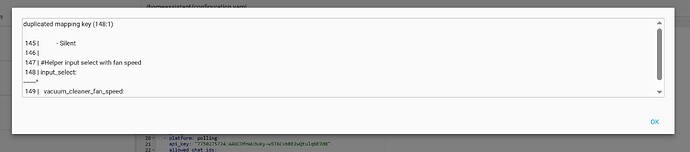

Hello
I’m new to HA, and your integration interests me and perfectly meets my expectations! I tried copying and pasting your code into my configuration.yaml file, and I’m getting an error message.
Could you tell me why this isn’t working? Maybe I didn’t copy it to the right place? Can you tell me where to copy each part of your code (config.yaml, etc.)?
Sorry, but I’m a beginner.
Thank you very much!
