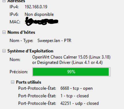

@mennosmit & @vipial1 have you tried doing a nmap scan of the ip that your vacuum is on? There might be another open port on that device… or maybe I got send a device that had issues and they forgot to put developer mode off :man_shrugging: Only have the 1 device
@luwidgiani Robeye® | Recognition Robotics is used on my Rowenta series 80
Capture d’écran 2022-12-11 105639
My Rowenta Smart Force Cyclonic Connect is probably a robart vaccum cleaner (robart.ai). It seems to be very similar to the previous descriptions, and I was able to do something
In my case, with nmap :
Not shown: 998 closed ports
PORT STATE SERVICE
443/tcp open https
10009/tcp open swdtp-sv

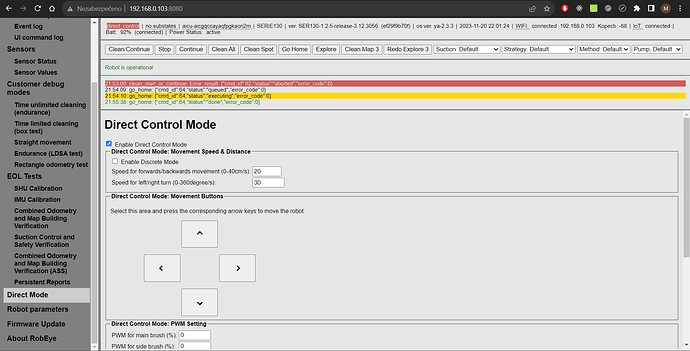

For new devices the situation is different. I have device Rowenta Explorer 130 series and there it seems that its their own product.
Fornunetly the integration should be easy to create.
Thanks for @peje66 message I have discovered that vacuum cleaner have the own app RobEye publicly accessible through the local network on port 8080
So far, I get investigation for the API, and it looks like it using simplified REST api just with GETs.
For exaple
Stop command GET 192.168.X.X:8080/set/stop
Home command GET 192.168.X.X:8080/set/go_home
Clean all  GET 192.168.X.X:8080/set/clean_all?cleaning_parameter_set=0&cleaning_strategy_mode=4&pump_volume=none

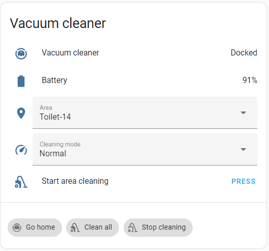

And here is my example dashboard card configuration, which looks like this:
type: entities
entities:
  - entity: vacuum.rowenta_vacuum
  - entity: sensor.vacuum_battery_level
  - entity: input_select.vacuum_cleaner_area
    icon: mdi:map-marker
  - entity: input_select.vacuum_cleaner_fan_speed
    icon: mdi:speedometer
  - entity: input_button.vacuum_cleaner_start_area_cleaning
title: Vacuum cleaner
footer:
  type: buttons
  entities:
    - entity: input_button.clean_kitchen
      show_icon: true
      show_name: true
I integrated your snippets with my Rowenta 80 Explorer series and it worked great! One thing that had me scratching my head for a moment is that declaring multiple input_select options in the configuration.yaml as separate blocks wouldn’t work for me. This should be turned into a real integration with how smooth it works.
