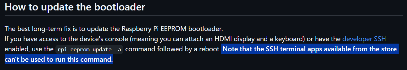

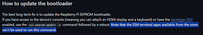

Yep, the github issue warns you about this in the first post:
Hook up a keyboard & monitor, then you should be able to check eeprom version & update from there. Step by step instructions are here.
