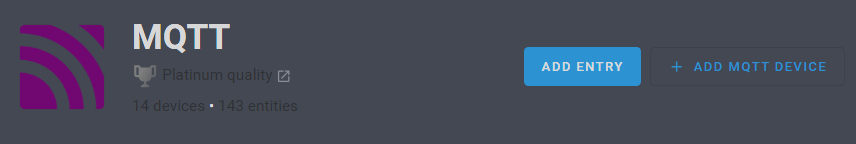

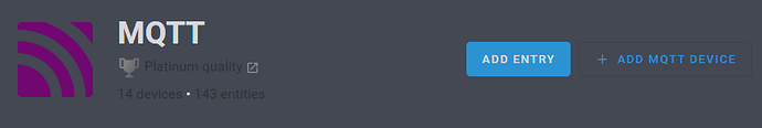

There’s also the option to specifiy manual MQTT devices with wildcard topics.
This way you can have a device instead of free floating entities.
state_topic: "home/OMG_heltec_rtl_433_ESP_OOK/RTL_433toMQTT/Nexus-TH/1/+"
This is the state topic for a temp/humidity sensor that changes id each time battery change. the “+” is the wildcard that replaces the ID
