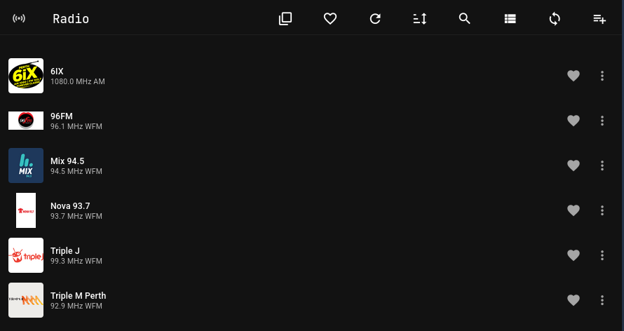

Turns a cheap RTL-SDR USB dongle into a radio tuner that streams FM/AM stations to your Chromecast or Squeezelite speakers. It integrates with Music Assistant so your radio stations show up alongside your other music, and you can control everything through HA automations.

  • Backend tunes the RTL-SDR and transcodes to MP3 (ffmeg and rtl_sdr)
  • Save your favorite stations as presets via the web UI
  • Music Assistant provider exposes those stations as radio items
  • Play to any MA-supported player (Chromecast, Slimproto/Squeezelite, etc.)
  • Automate with HA - “play Triple J in the kitchen when I get home”
