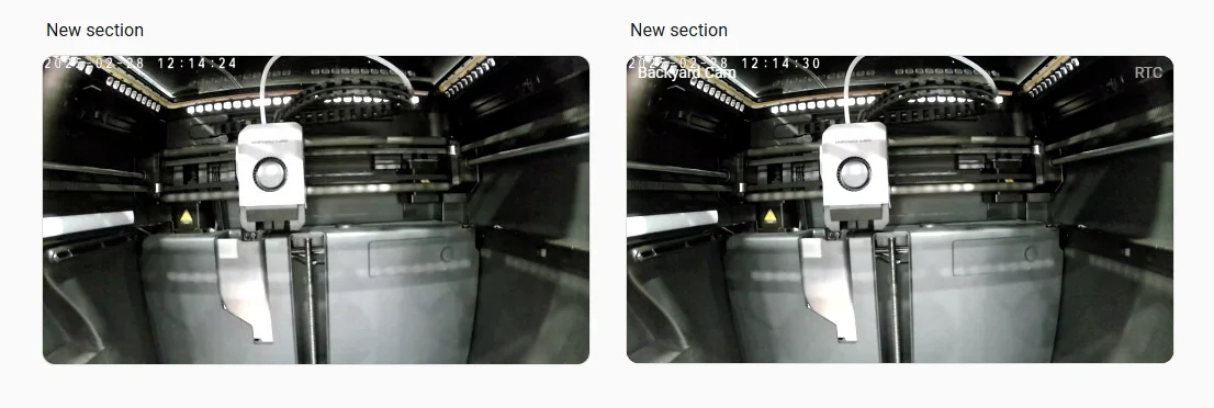

Not sure if this will work or not, but here is a link to a Video showing a comparison
Left = Generic Camera w/ Picture Entity Card
Right = WebRTC Custom Card
