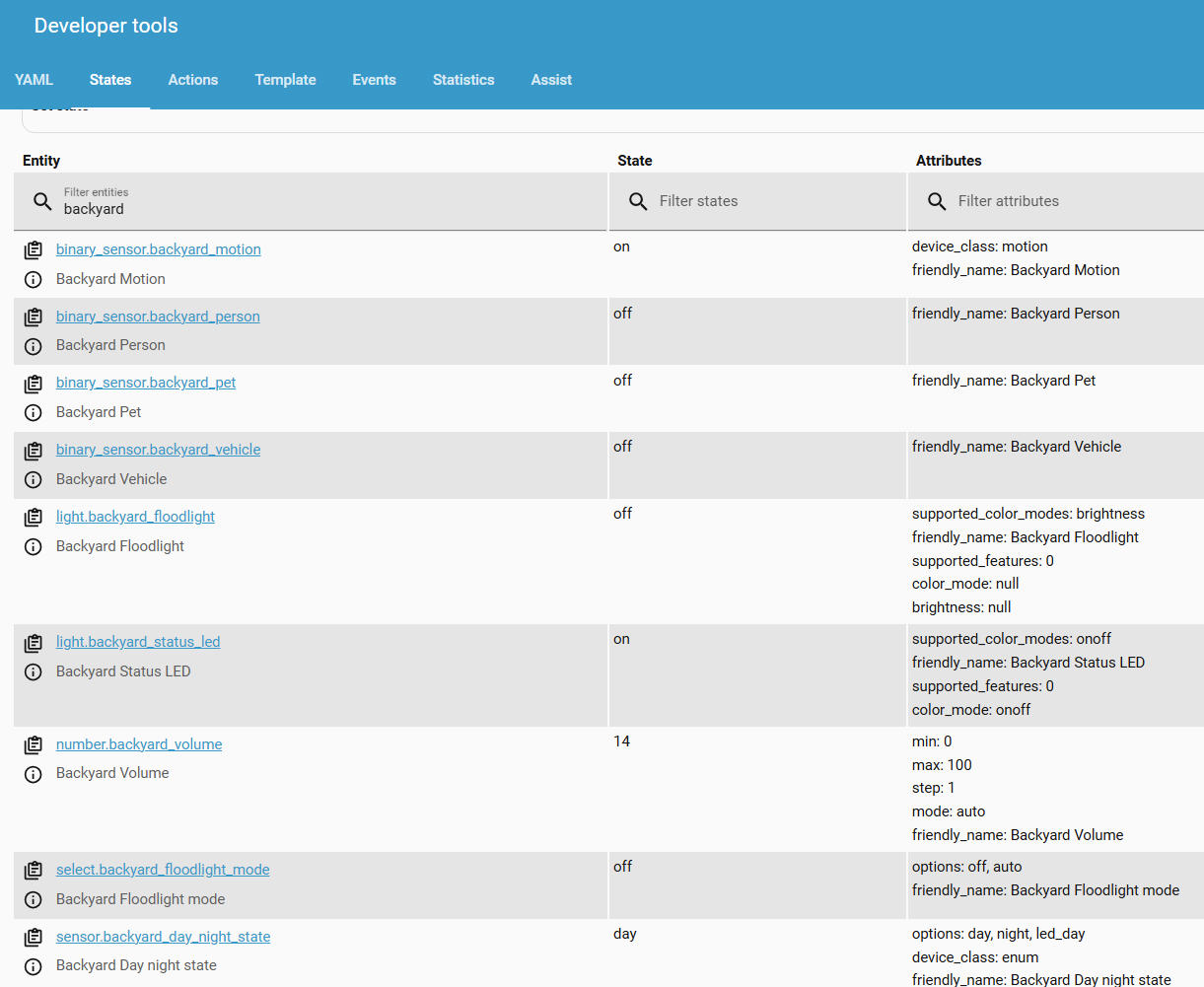

The camera works fine in the app on my phone and I can see 16 entities in the integration- except for the camera. Where is the stream?

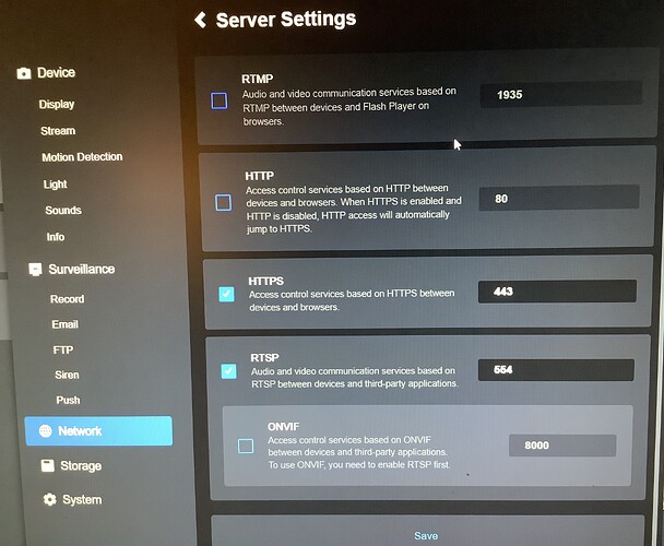

There’s a couple of things you have to enable/setup in their app. I remember it being far from straightforward, probably because the exact process/steps have changed from when the docs were written. When I got a second camera it was easy, because I just made sure all the settings were identical. :slight_smile:
Good point. I forgot that I had to enable additional ports in the reolink camera settings to get Rtsp working
And… what settings?
These are the ports I enabled for the camera using the reolink app
On what device??
When I first set up my Reolink network settings for streaming, I went directly to the camera’s IP address in my browser and logged in.
Edited to add: You can also install the Reolink Client on a pc (mine is on installed on MacOS, but I think it’s available for Windows too…last I checked there was no Linux Client which is my main OS, so when necessary I just use the browser). The clients will also get you to the Network settings.
The Generic Camera integration has been depreciated for quite a while; replaced with the Advanced Camera Card Integration. But you missed my initial question. The Reolink shows a lot of entities for the camera, except for the camera itself.

Not sure if the Network settings are available in the Reolink Integration…it’s been a while, but from what I remember the network settings have to be set in the camera itself…before it can be used for streaming in HA.

But, as I mentioned, if I remember correctly I had to do the network config for RTSP in the camera itself before using either of the cards.
This explains how to enable the rtsp port on Reolink cameras

In the ReoLink program:
Server Settings:
Basic Service: Port 9000
RTSP: Port 554
ONVIF: Port 8000
