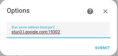

I have read that a stun server should be configured. So I added the google one stun.l.google.com:19302 into the RTSPtoWebRTC integration configuration and reloaded it.
No success, no javascript error, nothing in the logs.
