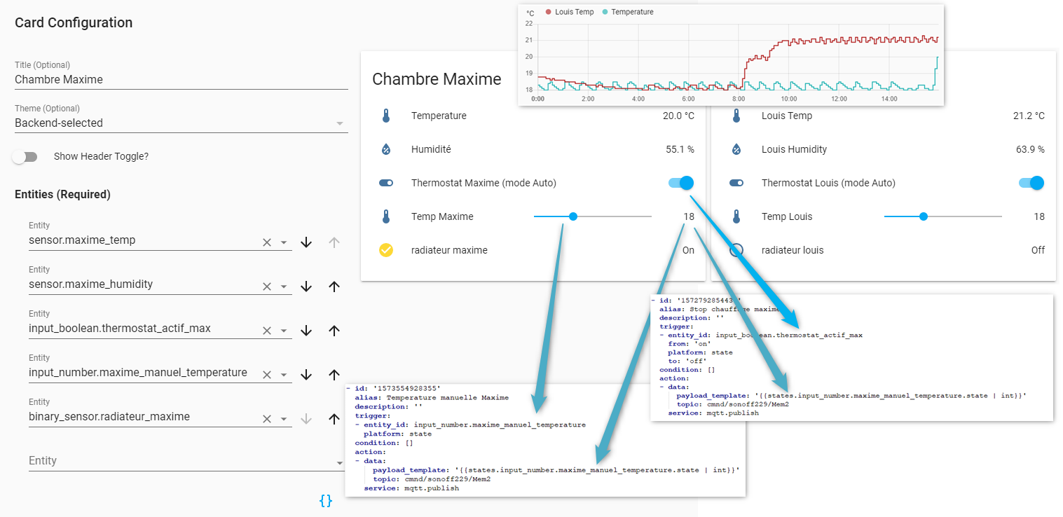

And this is the result. I manage two sonoff TH, one for each rooms and set two different automation as one of my son is out all the week and the youngest stay at home.
