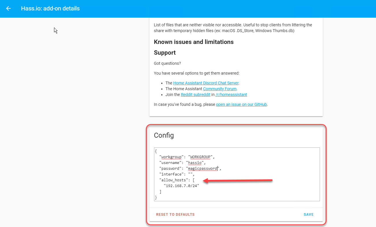

The actual VM folders aren’t directly exposed to the network. The Hass.io appliance with its Docker container has internal NAT. For access to the config folders I also use the Samba share add-on within Hass.io. You have to configure it correctly, and it’s a bit clumsy I’ve found, but it does work. It’s picky about the syntax of your credentials.
In the add-on details you’ll find the config area. Set it up with a username and password and restart the add-on. Also pay attention to the “Allow Hosts” bit - here I have specified a particular subnet, but you could define one host, multiple hosts, subnets, or a combination thereof.
And yeah that’s not actually my password.
When you browse to it you’ll be prompted for credentials. The entered creds should look like this:
