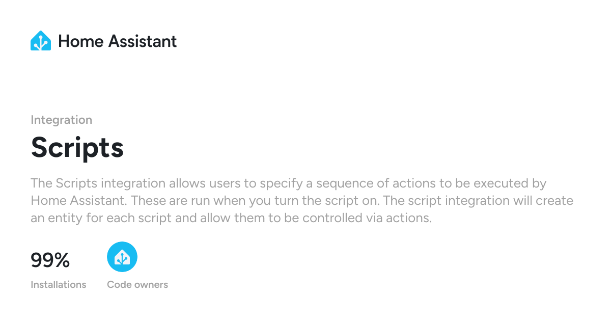

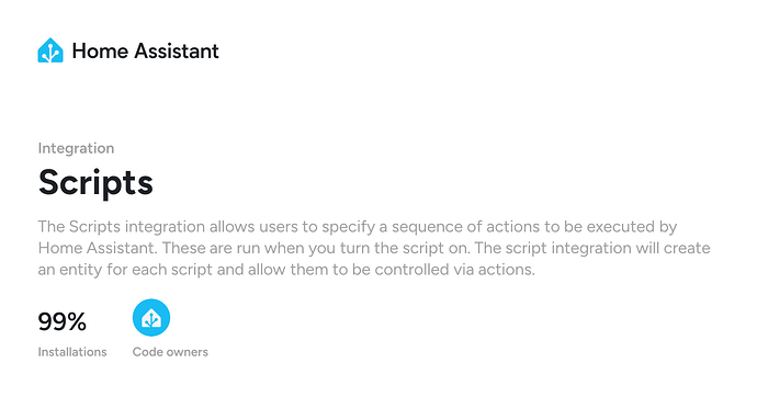

just for a reference:
could it be that, the script you are calling is having syntax issues?
