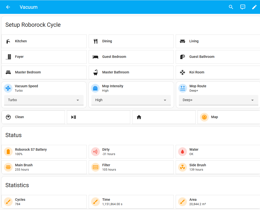

in my setup, I have a script:
alias: Run Vacuum
sequence:
  - data_template:
      command: app_segment_clean
      params:
        - segments: |
            {% set vacrooms = namespace(roomid=[]) %}
            {% for rooms in state_attr('sensor.roborock_rooms','rooms') -%}
              {% if is_state(rooms.boolean,'on') %}
                {% set room = rooms.id | int %}
                {% set vacrooms.roomid = vacrooms.roomid + [room] %}
              {% endif %}
            {%- endfor %}
            {{ vacrooms.roomid }}
      entity_id: vacuum.roborock_s7
    action: vacuum.send_command
mode: single
icon: mdi:robot-vacuum
With that sensor populated from JSON:
    "rooms": [
            "name": "kitchen",
            "boolean": "input_boolean.vac_kitchen",
            "id": "17"
            "name": "dining_room",
            "boolean": "input_boolean.vac_dining_room",
            "id": "16"
            "name": "foyer",
            "boolean": "input_boolean.vac_foyer",
            "id": "26"
            "name": "koi_room",
            "boolean": "input_boolean.vac_koi_room",
            "id": "24"
            "name": "living_room",
            "boolean": "input_boolean.vac_living_room",
            "id": "19"
            "name": "master_bedroom",
            "boolean": "input_boolean.vac_master_bedroom",
            "id": "21"
            "name": "guest_bathroom",
            "boolean": "input_boolean.vac_guest_bathroom",
            "id": "23"
            "name": "guest_bedroom",
            "boolean": "input_boolean.vac_guest_bedroom",
            "id": "18"
    "points": [
            "name": "sink",
            "x": 17989,
            "y": 25491
The sensor created as:
## Roborock Rooms
- platform: rest
  resource: http://192.168.1.245:8123/local/Roborock/roborock.json
  value_template: "{{ now() }}"
  json_attributes:
    - rooms
    - points
This sounds like a more robust and flexible solution, I’ll sure try it out.
