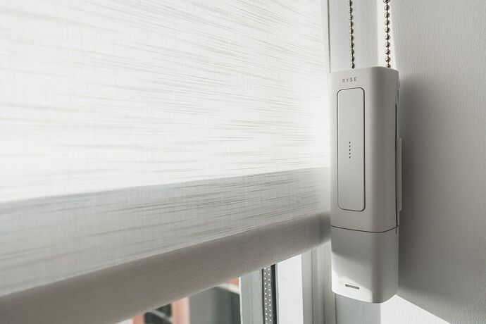

Anyone check these out? Can’t find anything at all to see if they could be HA managed. Has its own hub but can’t find any specs.

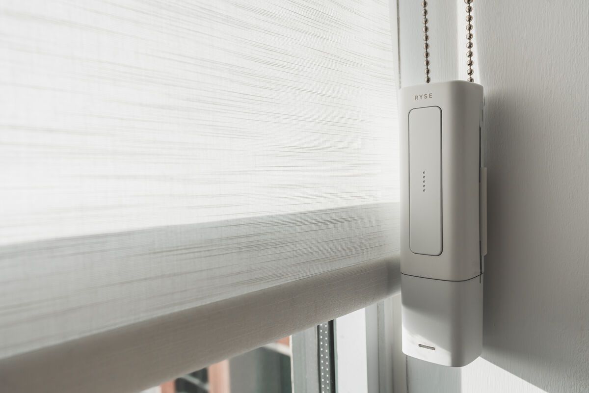

These are the new version of the Axis Gear. There has been a little conversation about those in the past. However, I believe Gear was Zigbee and Ryse are bluetooth/wifi. Maybe with the hub it could be possible?

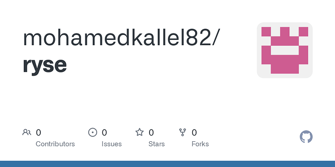

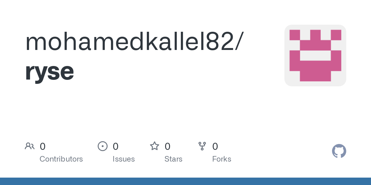

You can connect the RYSE smart shades directly to the home assistant via BLE, you can use the following official custom component from RYSE:
