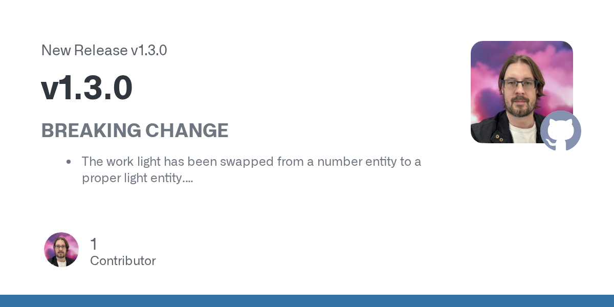

1.3.0
  • Adds firmware version
  • Adds a sensor for next wake time
  • Handles re-authentication
  • Replaces the work light sensor with a light entity
  • Removes some duplicate sensors leaving just the controls
  • Some refactoring to make maintenance simpler

Love the new updates. Sadly I had to revert back to v1.2.3 as v1.3.0 didn’t work. All the entities would turn ‘unavailable’.
Fixed in 1.3.1. Sage changed the way the API was returning a blank schedule list. Now resolved, and hardened a little against future changes.

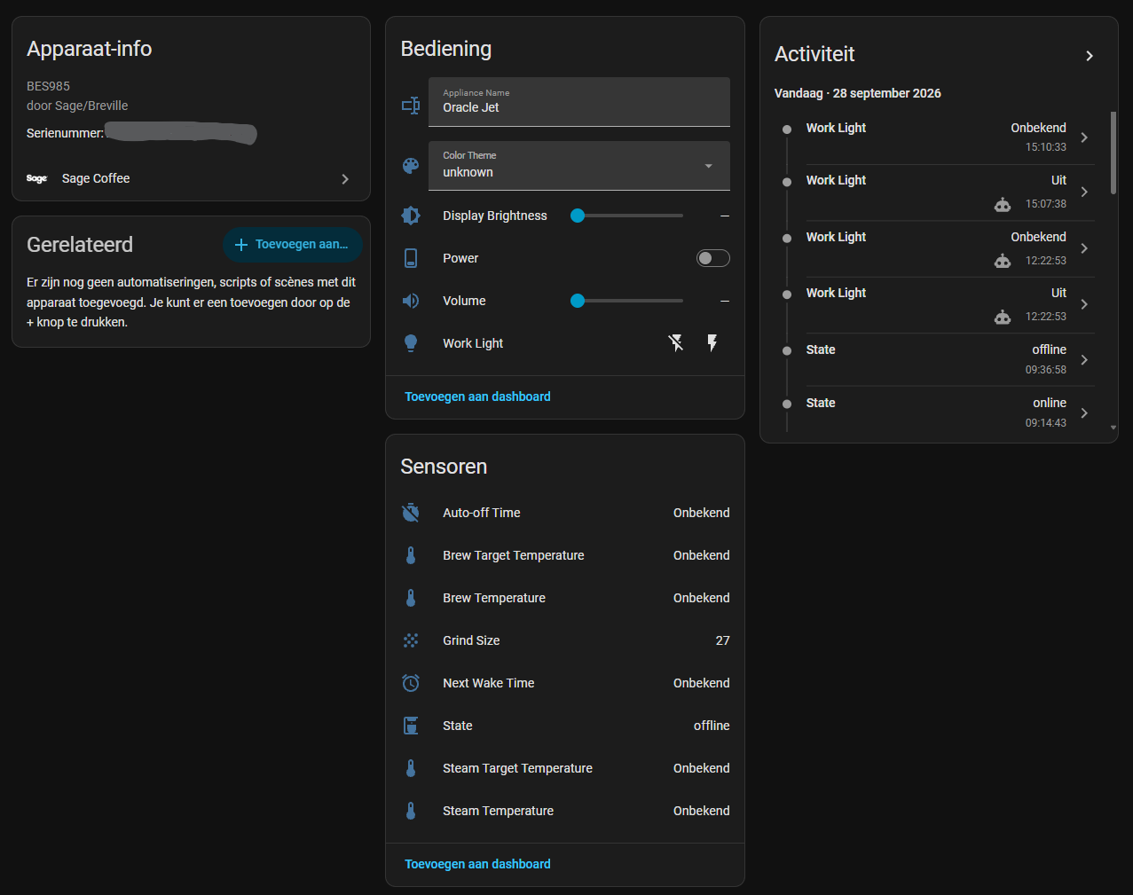

I received an update last week for my sage oracle jet (SES985). I tried the integration and it appeared in HA. I see status changes like power on/off, but the button isn’t working. Will this type be supported in future updates of your integration?
