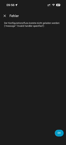

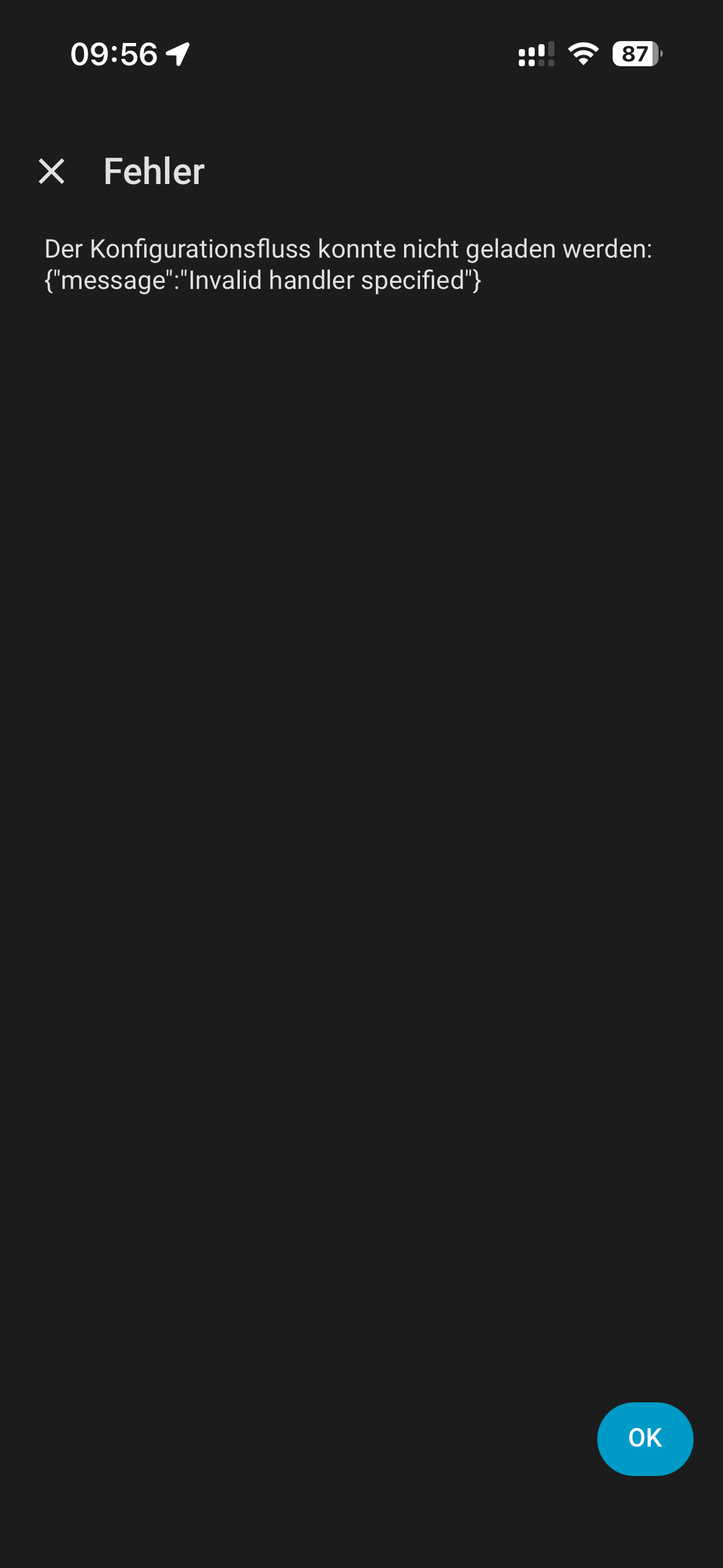

Wow cool, I was looking for this since I got my duo Boiler month ago and now you Build it. I am just getting an error Setting up the Integration. Hacs install works Fine.
Some more input from my side:.
Logger: homeassistant.config_entries
Quelle: config_entries.py:3969
Erstmals aufgetreten: 13:27:36 (1 Vorkommnis)
Zuletzt protokolliert: 13:27:36
Error occurred loading flow for integration sagecoffee: cannot import name ‘CONF_MACHINE_TYPE’ from ‘custom_components.sagecoffee.const’ (/config/custom_components/sagecoffee/const.py)
Changed CONF_MACHINE_TYPE inside the plugin everywhere to CONF_BRAND
that was solving the error. Maybe you can update your git @simonjgreen

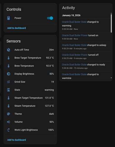

I know I said this before but this is probably one of my favorite integrations in Home Assistant. I love being able to make it part of my morning automation. Setting the working light to 100% (visual cue) and using ChimeTTS (audio cue) to announce when the Breville is ready

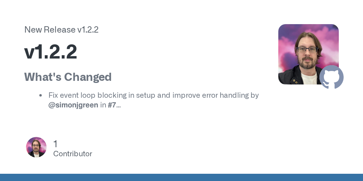

Note for all, I have created a test release here attempting to resolve the memory leaks that are crashing home assistant instances. Feedback appreciated after a few days of running!

Took me a while to realize this but HA Core is crashing every few hours because of this integration.
Currently only works with Sage/Breville Oracle Dual Boiler.
This is being worked here Crashing Home Assistant · Issue #6 · simonjgreen/sageha · GitHub
It’s not happening to me, or a friend of mine, but is definitely happening to some folks! If you happen to have instrumentation/profiling enabled in your HA install I’d welcome any detailed logging you might have in that issue. Additionally trying the latest pre-release version would help.

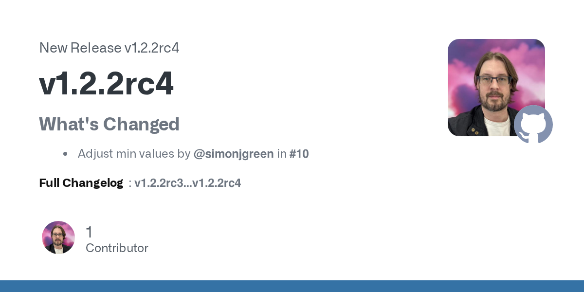

The work light bug (and additionally the screen backlight and volume) have all been adjusted to have a min of 0. My bad!
Feedback confirms memory leak now fixed. Also adjusted the min value on the two lights plus the audio to go all the way to 0.
Oh this is awesome!!! Also can report the crashes have been fixed with 1.2.2, thank you so much!
