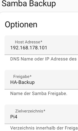

This is my configuration (you can also write your interal IP addresses here, as no one can reach them):
and this is the log:
So the ā€žnormalā€œ path to the folder (this can directly be used eg. on a Mac) would look like that:
smb://192.168.178.101/HA-Backup/Pi4
I donā€˜t know if lower and uppercase is important, but maybe it is.
Are you sure you have the correct rights set for the user ā€žhomeassistantā€œ with the specified password for the share itself and also for the folder you are using?
