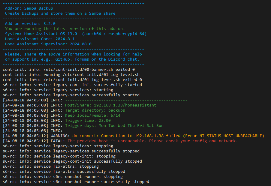

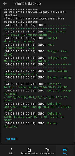

looks like that after a few days, the backups stop working and revert either to the stock config or an old config I made in the beginning, but only regarding the scheduled time :
They start at 4am, but my NAS is off at that time :
