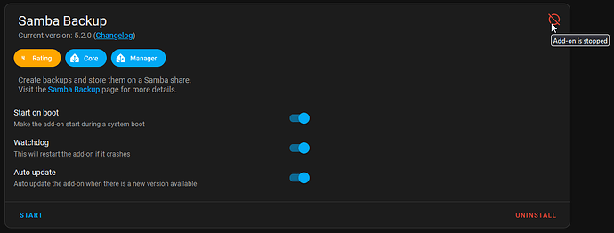

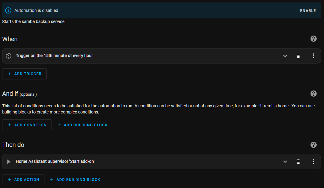

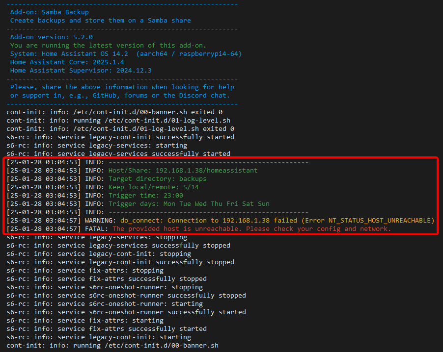

I’m still having issues with this addons stopping on it’s own (despite having the watchdog setting on)
I had a workaround in place for a while which was an automation that starts the addon every 15mins :
But I decided to disable it to see if the issue still exists, and it does.
After a few days, SB starts to ignore the configuration and tries to backup at 3am even though the config says to run the backup at 23:00

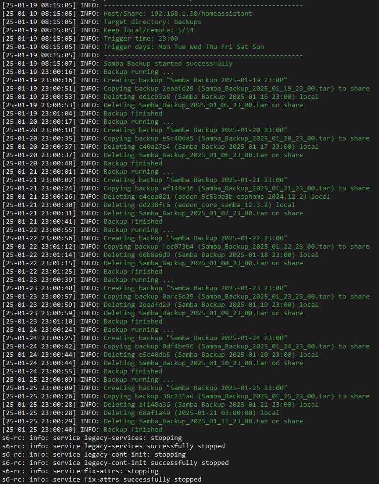

Here’s an example on a successful backup running at 23h00 without issues :
Any idea ?
Thanks
Based on screenshot you provided, you set
target_dir: backups
You missing forward slash (/), so it must be
target_dir: /backups
Why is it working for days and then stops working then ?
