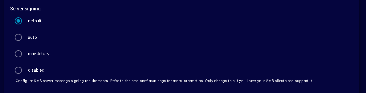

I had a similar issue with the “Failed to validate addon configuration”
There was a bad update that got pushed a little bit ago that caused that error for me.
Make sure you have updated the addon to the latest version, then under configuration, make sure something is selected here (I selected default), then hit save and restart the addon.
