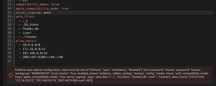

It would seem the latest Samba update did not get its full AddOn screen updated. The new “Server Signing” option has to be an radio select, but it’s giving just a singular radio button:
When trying to fix it manually, I’m getting an error it has to be “one of” options:
I tried with and without quotes (should be without). But, no luck…

I went in settings and checked a radio button. At least it loaded now, I can’t check if it works atm.
