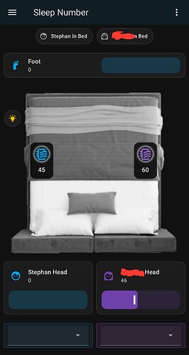

I just got my I8 today and quickly created this on an ancient android tablet I had laying around. Plan to make it look pretty once we settle on what we want on the dashboard and where.
I just got a SleepNumber bed and wanted to see if you would be willing to share your dashboard?
would you be willing to share this? it looks great!

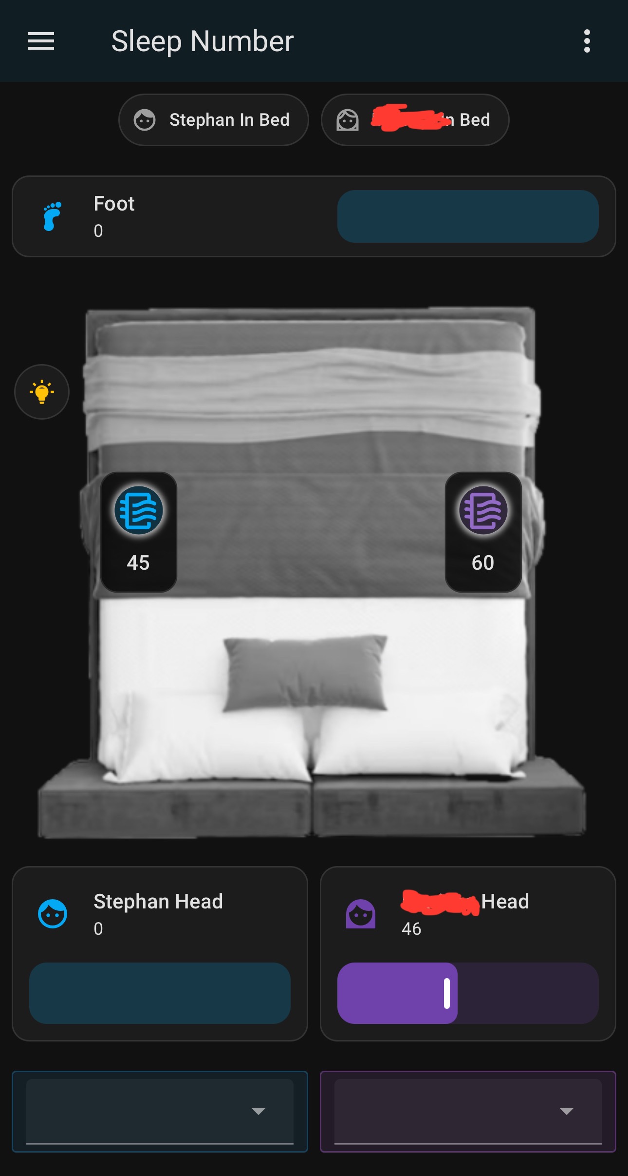

I have changed it quite a bit since then.
It looks like this now:
Do you have a link to the card/code you used? Love this.
Here’s the entire view I created. I used Mushroom Cards and Card-Mod for more personalization. I think a lot of the new built in Tile cards can be used instead with the recent updates.

Thank you. Great Dashboard.
I’ve got everything working but the background image.
Can you please provide guidance on where, exactly the image goes and the format?
chris
I uploaded the image via the UI (Visual Editor) in the Picture elements card
