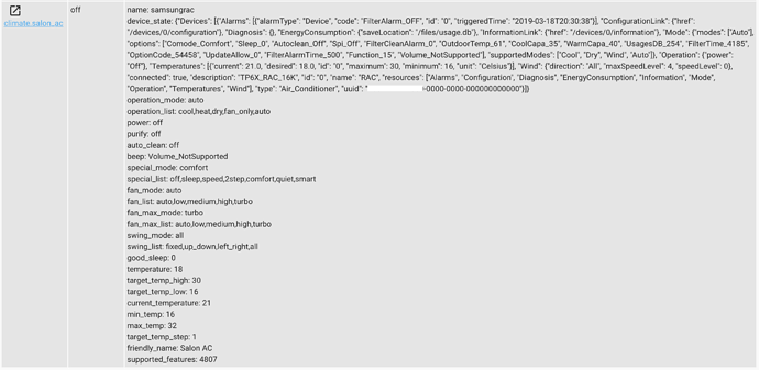

Save for getting the outside unit’s temperature. I also tried to get the data from the device_state attribute but I think the templating engine interprets it as a string, rather than a json/dict.
Here’s my configuration (excerpt):

Here’s the (abbreviated) response to GET /devices:
