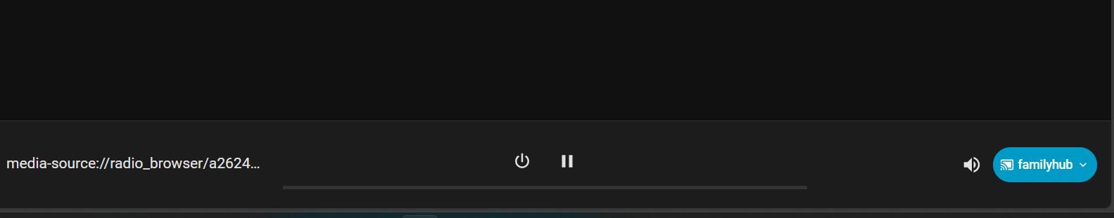

Hi everyone,
Did someone succes to use the fridge as a mediaplayer ?
I would like to listen some radios with it.
Thanks a lot :slight_smile:
Yes,easily
how did you manage that ?
you need to install BrowserMod. GitHub - thomasloven/hass-browser_mod: :small_blue_diamond: A Home Assistant integration to turn your browser into a controllable entity and media player
