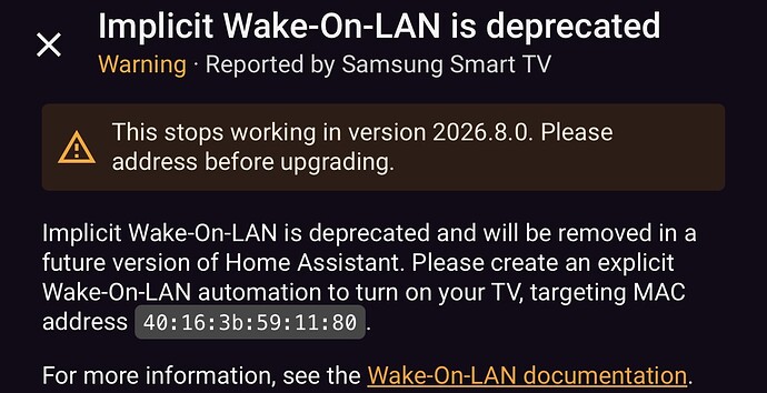

I read the linked info and the actual change here:
I think I’m just supposed to create an automation that uses the same media_player trigger to explicitly send the magic packet.

After installing 2026.02 udpate, when I say that same phrase, this deprecation warning start appearing.
I read the notes (including provided PR) but I don’t understand what should I change/add to keep having the same.
