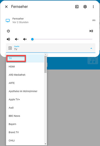

However, I still fail to simply change the source to TV (eg after using Netflix or YouTube). It does neither work via selecting TV as source in the dashboard media player card (whilst selecting any other source like eg Netflix does sucessfully change the source)
… nor does the following service work to change the source to TV (whilst selecting any other source like YouTube, HDMI or Netflix works)
service: media_player.select_source
  source: TV
  entity_id: media_player.fernseher
What am I doing wrong???
