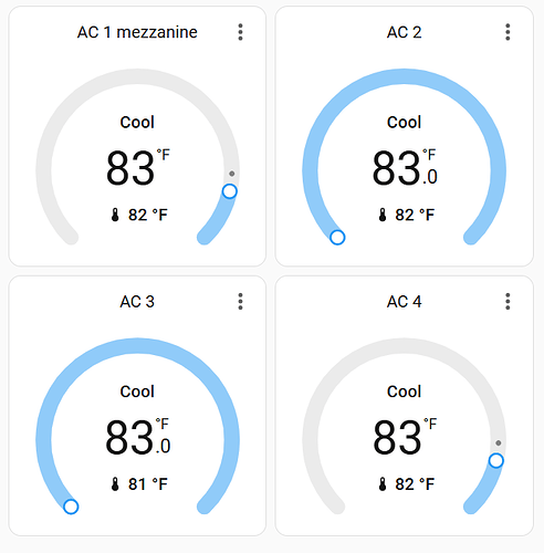

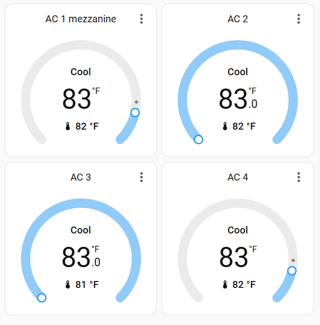

The plot thickens.
Looking at the Card in HA for the three, this is what is displayed…
Notice that the two problem ones are displaying a WIDE arc for the temperature range with the current temp at the bottom. This arc represents that ridiculous error range mentioned above.

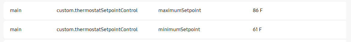

When I check in my Smarthings dashboard it lists the acceptable range like the others between 61 and 86.
So the details of the “AC” object exposed by Smartthings Integration shows the following YAML which has the incorrect values for min and max. Now to try to find where these are coming from,
