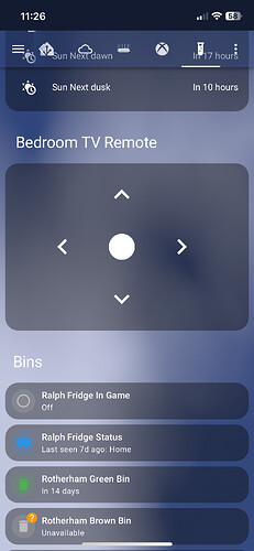

I couldn’t get anything to work, I just get this. Tried with 2 Samsung TVs
Having the same issue as Paul : only buttons left/right/up/down and no reaction if I click the button. Any idea?
Thanks rupin works perfect!
I had the same issue as the two above, but I found out I added the wrong tv-card through HACS. The correct name of the card in HACS is “TV Remote Card (with touchpad and haptic feedback)”, not to be confused by “TV Remove Card”. "TV Remote Card (with touchpad and haptic feedback) " is a fork of “TV Remote Card”
I linked the card in my post from the start
