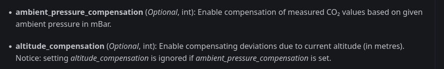

I didn’t use the barometric pressure compensation but altitude compensation (set to 303 m in the esphome yml above). Which is exclusive with the pressure as per documentation.
