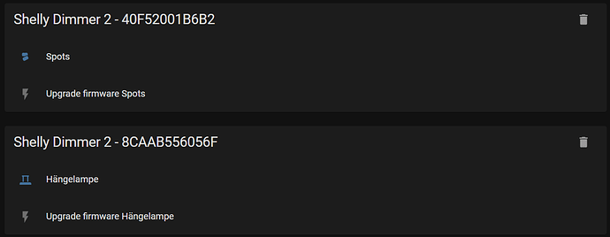

Actually, I have a very similar challenge with Shellys: The ShellyForHass integration provides an additional switch for each device to update the firmware. The switch is typically in unavailable
state until fresh firmware arrives. Then it becomes available, but off. Switching it on initiates the firmware update process, after which the switch goes back into unavailable
state. Essentially, this is mimicking a push button.
When I add a light entity from such a Shelly device to a scene, HA picks the whole device including the firmware switch.
When I activate the scene, this results in an error log message:
2021-09-03 15:58:19 WARNING (MainThread) [homeassistant.components.switch.reproduce_state] Invalid state specified for switch.shelly_corridor_bedroom_dimmer_firmware_update: unavailable
2021-09-03 15:58:19 WARNING (MainThread) [homeassistant.components.switch.reproduce_state] Invalid state specified for switch.shelly_corridor_ceiling_firmware_update: unavailable
2021-09-03 15:58:19 WARNING (MainThread) [homeassistant.components.switch.reproduce_state] Invalid state specified for switch.shelly_corridor_wall_firmware_update: unavailable
2021-09-03 15:58:19 WARNING (MainThread) [homeassistant.components.switch.reproduce_state] Invalid state specified for switch.shelly_dining_firmware_update: unavailable
2021-09-03 15:58:19 WARNING (MainThread) [homeassistant.components.switch.reproduce_state] Invalid state specified for switch.shelly_kitchen_ceiling_firmware_update: unavailable
2021-09-03 15:58:19 WARNING (MainThread) [homeassistant.components.switch.reproduce_state] Invalid state specified for switch.shelly_kitchen_spots_firmware_update: unavailable
2021-09-03 15:58:19 WARNING (MainThread) [homeassistant.components.switch.reproduce_state] Invalid state specified for switch.shelly_livingroom_sofa_firmware_update: unavailable
2021-09-03 15:58:19 WARNING (MainThread) [homeassistant.components.switch.reproduce_state] Invalid state specified for switch.shelly_livingroom_tv_firmware_update: unavailable
In essence, this is the same problem as what @gazpachoking describes. I want to add just the light entity, not the switch entity for the firmware.
