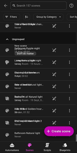

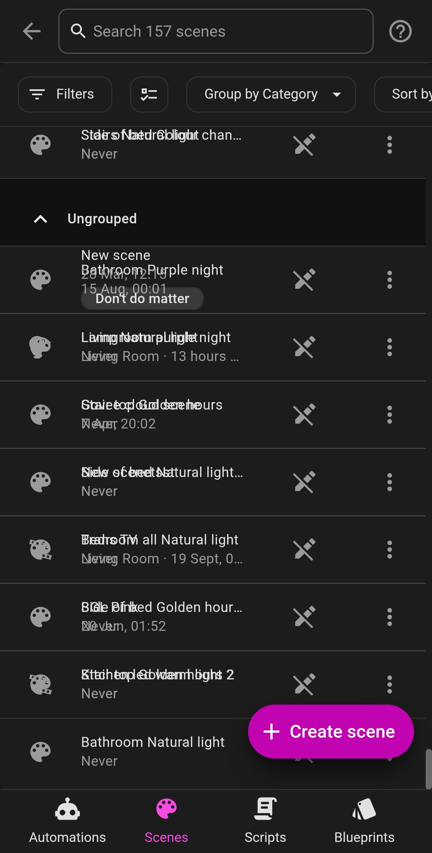

I really didn’t where to put this. But if I’m scrolling down my scene list it gets to a certain point and skips… now these are hue scenes and I know it’s ones I had trouble with the other day (In Alexa mainly)
It just gets to L. And wants to avoid it. I’ve tried to reload scenes. Reboot. Both HA and the Hue hub but it just keeps skipping. In the app and on the web.
I’m not sure what to do. Other than a total purge of the scenes but I worry that will make it worse. They still work. They can be added to automations just fine. I just don’t understand this behaviour.

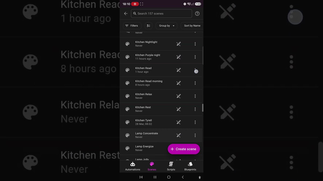

Here’s a little video..

I Believe I fixed it? I went into the scenes yaml and found Energise. I changed it to Enrgize and we seem ok again.
I should have probably mentioned what started this.
I had some trouble with some scenes not working with alexa. It seemed even though it’s hearing me say energise. It changes it to Energize… so I changed all my energize scenes on hue to have a z and I dunno. I guess that broke it for some reason. But only with that one…
I went into the scenes.yaml and looked for the word energise and it came up with the s so I changed it to a Z and now it seems OK…
